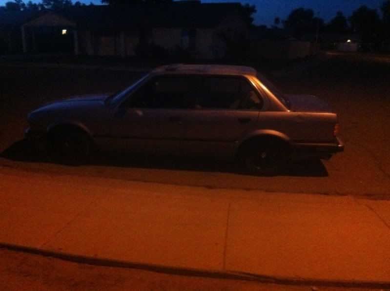

So I picked up a BMW again.
Specs
1988 325e manual 250xxxmiles!!!
No big plans for the car just daily status ASAP.Lower it and clean it up.
I've started to do lots of the basic maintaince that it needs badly.
J-B welded vacuum nipple back into TB, Fuel filter, spark plug, new battery, new neg battery cable, New vacuum lines(FPR, vavlecover breather, hard asfcuk under the manifold/behind the TB to evap canister hose.)
Just did valve adjustment.
Need to do waiting on parts.
TIMING BELT. (will be here 2/21)
Water pump
Here's what everyone wants!! Pics!!
